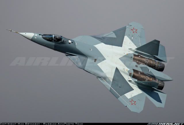

As far as colour scheme goes, I have two options below:
At the moment, I'm leaning more towards T-50's colour, since I'm planning to use the Flanker's one on the Su-47 when I get around to building it. Does anyone know the FS number used for this scheme?

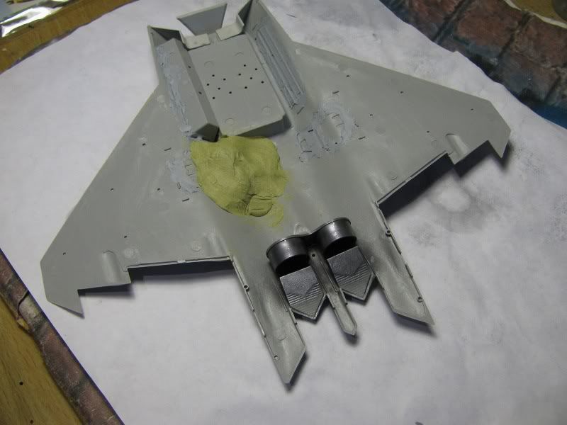

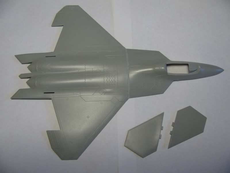

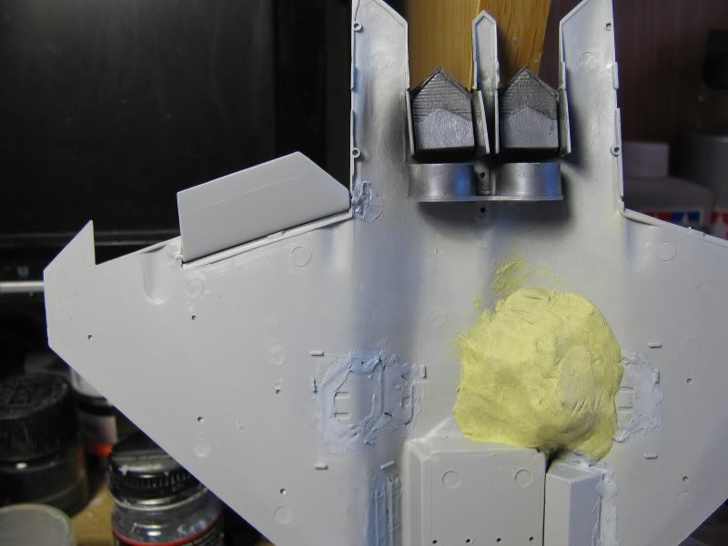

Just like the 1st Italeri Raptor I built almost 2 years ago, the part I hated the most was joining the two halves of the top fuselage.
I used the left main gear well for the domed nut that I'll use to mount the plane on a cheap camera tripod. I used Milliput to hold the domed nut in place.
I closed up all the missile bays, except for the Sidewinder bay on the left side. I'm planning to display the plane about to fire an inert Sidewinder.

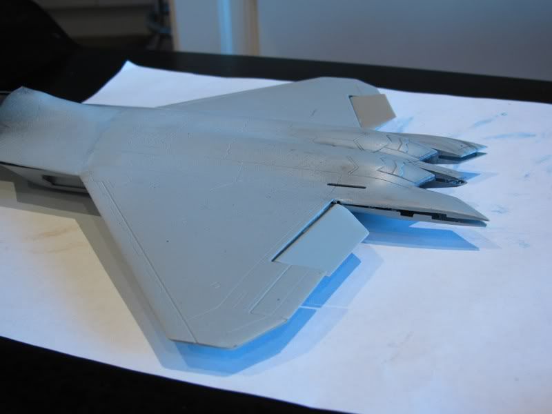

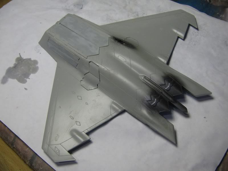

Another tricky part with Italeri's Raptor is the aileron. I used combination of Tamiya cement and Tamiya Basic Putty to hold the aileron in place, positioned just the way I want them....
I then proceeded with gluing the top fuselage to the bottom part (rear), which presented another challenge. Due to the size of the plane, I find joining top and bottom fuselage halves is always a challenge, no matter the manufacturer. I encountered similar issue with Revell's Raptor that I built 7-8 months ago. I decided to use a different tact, by gluing middle of the fuselage first and let it dry, which is the current state of the model.

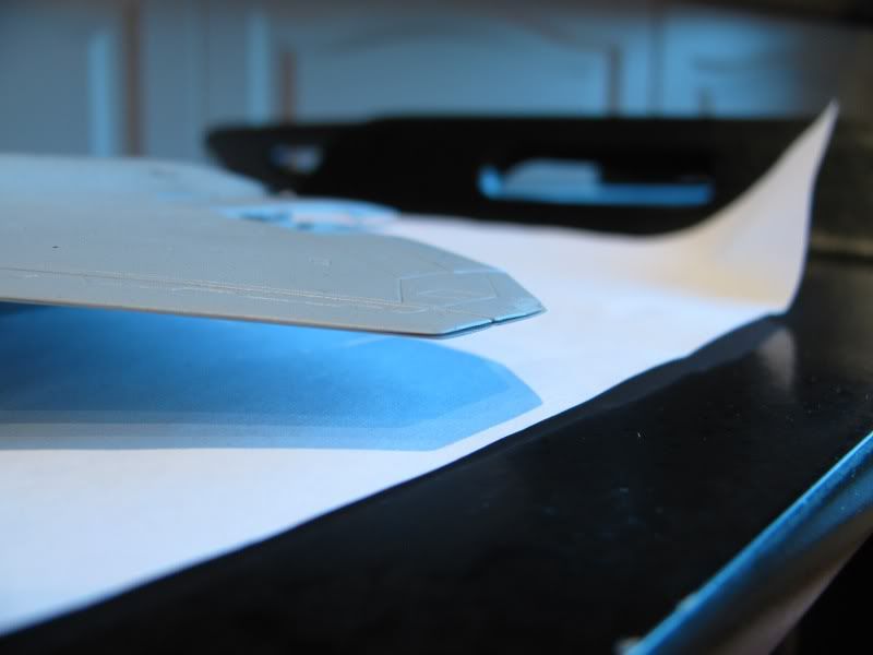

I noticed a slight gap on the wingtips, as pictured below. There seems to be some kind of "stray plastic" inside that prevented the wingtips to join perfectly. I made a mistake of not dry fitting first this time. Does anyone know of the best (and easiest) way to fix this? I'm worried that Tamiya Basic Putty may not cut it.

There are FS numbers available for the 'Arctic Flanker' scheme that the F-16s wear, although any FS numbers for a genuine Russian machine would be approximates as the Russians don't use the Federal Standard.

I'm only after an approximation really. In my eyes, the grey appears to be fairly close to FS35237 albeit these look a bit lighter. I'm hoping someone on this forum knows of a better match (preferrably in either Gunze's Aqueous Hobby range, Tamiya acrylic, or Lifecolor).
As far as Arctic Flanker colour goes, IMHO, this "new" scheme I want to use is nothing like Arctic Flanker. I've got TwoBobs Blue Fox Bandits decal sheet that has 3 different "Flanker" schemes (Blue, Arctic, and Lizard).

I agree totally, the PAK-FA scheme is world's apart from the Arctic Flanker.  If you have a chat to Redstar72 on here, he might be able to help with the colour callouts.  He's from Minsk and an absolute goldmine of info on all things Russian & a top bloke to boot!

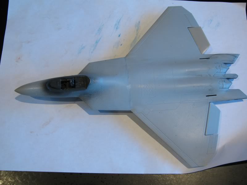

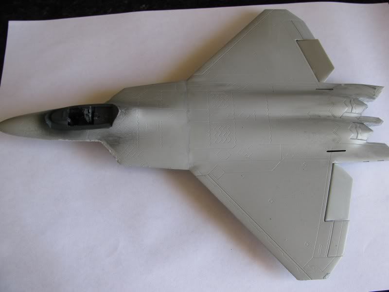

Just a quick update...... A couple of pics of the current state of the Raptor... Been busy these past few days cleaning up unwanted/unused crap around the house, re-arranging the study, and whatnot.....

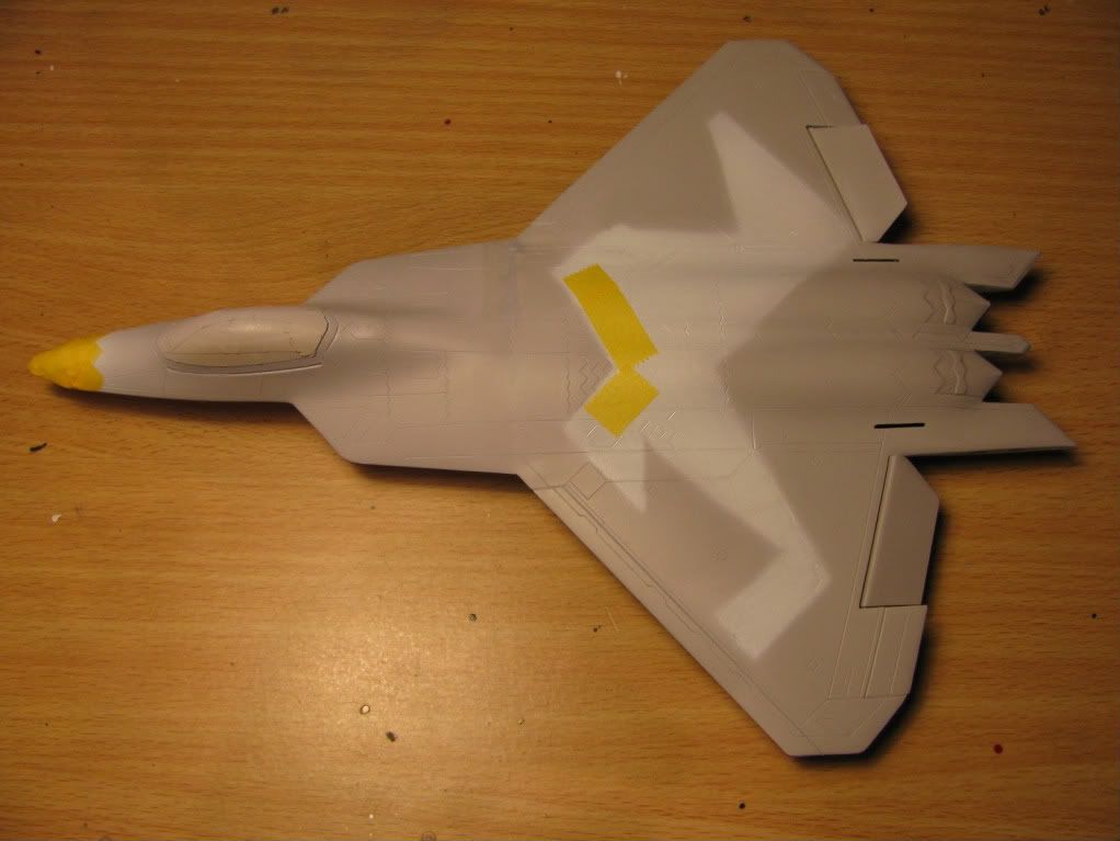

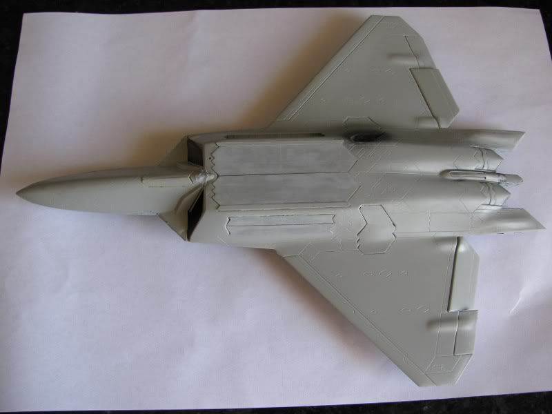

I've been doing LOTS of putty-sand-putty-sand-putty-sand-putty-sand-putty-sand-putty-sand.... Un-freakin'-believable!!! I don't know what the heck happened with me. Barely 6 months ago, I wouldn't have bothered doing so much puttying and sanding. I finally decided that I've done enough puttying and sanding mid last week.
With so much puttying and sanding, some of the panel lines naturally disappeared. At first, I wanted to simply left 'em, but decided to try rescribing for once..... Well, all I can say is I've done the best I could...   :-\
And, oh, along the way, managed to break the port aileron!!! DARN IT!   :angry:  :banghead:   Good thing I managed to somehow glue it back.
Sprayed a thin coat of primer (Tamiya Fine Primer - Light Grey), realised I bloody missed another section where the front and rear top fuselage joins... MORE PUTTYING AND SANDING!!!   :banghead:
Anywhoooo.... Last weekend, I started painting this beastie.... Now... for the colour, I decided to do something different here. Rather than the standard 2 shades of grey and white, I thought I'd put some blue tint into each colour. So, some weeks back (probably 2.5 weeks ago), I spent countless hours mixing different shades of grey and blue to try to come up with something that *I think* somewhat believable. :P
Here's what I decided to use:
- Light grey: LifeColor UA026 (FS36375), tinted with a few drops of Gunze's Aqueous Hobby H322 (Phthalocyanine Blue)
- Dark grey: 3 parts of Gunze H317 (FS36231) + 1 part of Gunze's H322
- White: LifeColor LC51 FS17925 (Gloss White) tinted with a little Tamiya Sky Blue
The bottom part was actually sprayed with Gunze's Gloss White (H1) by mistake. I'll need to respray a thin coat of the tinted white a bit later.
In case anyone is wondering, I was using a template that I created myself.
