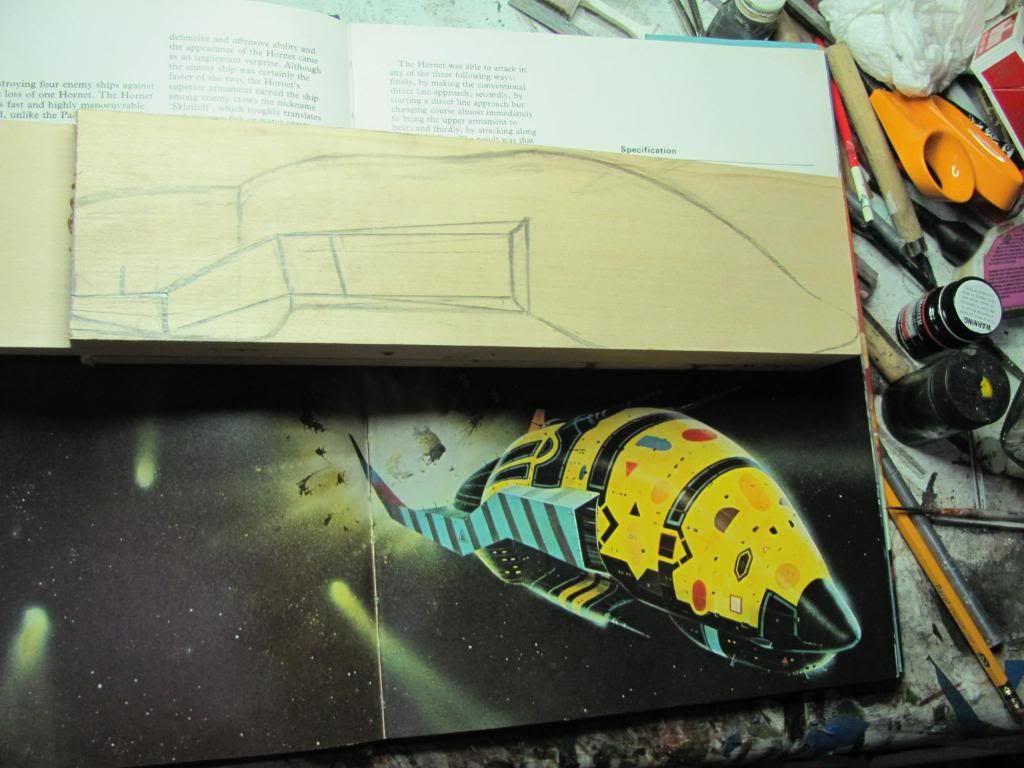

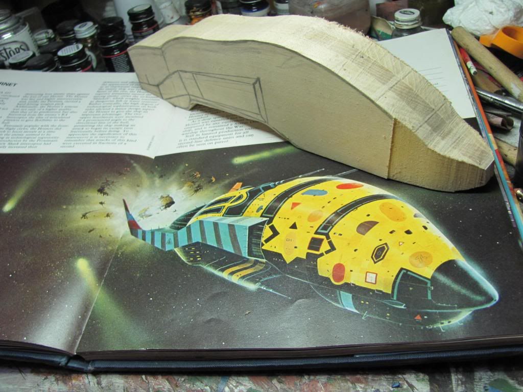

So I could not find anything that I could kitbash into this :banghead: So here it goes my first total scratchbuild :blink:
This will be a serious test of my skills :thumbsup:

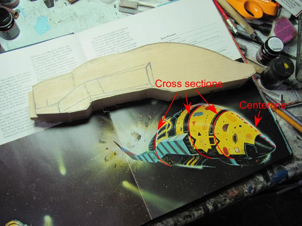

Looks like a good start, Ron. Do you have cross sections drawn up to keep the fuselage sides symmetrical?
Um Frank I would not even know how to do that. :blink:
frank2056
Quote from: sotoolslinger on November 12, 2010, 02:11:15 PM
You already have a side view - unless you have a 3 view of the original, you can make a guess at the cross sections - just to keep the two sides equal.
Here's your picture, illustrated:
Here's a paper model of the Hornet It may give you some construction ideas.
Also, I think Dr. Yo made a Hornet - he may pipe in with suggestions.

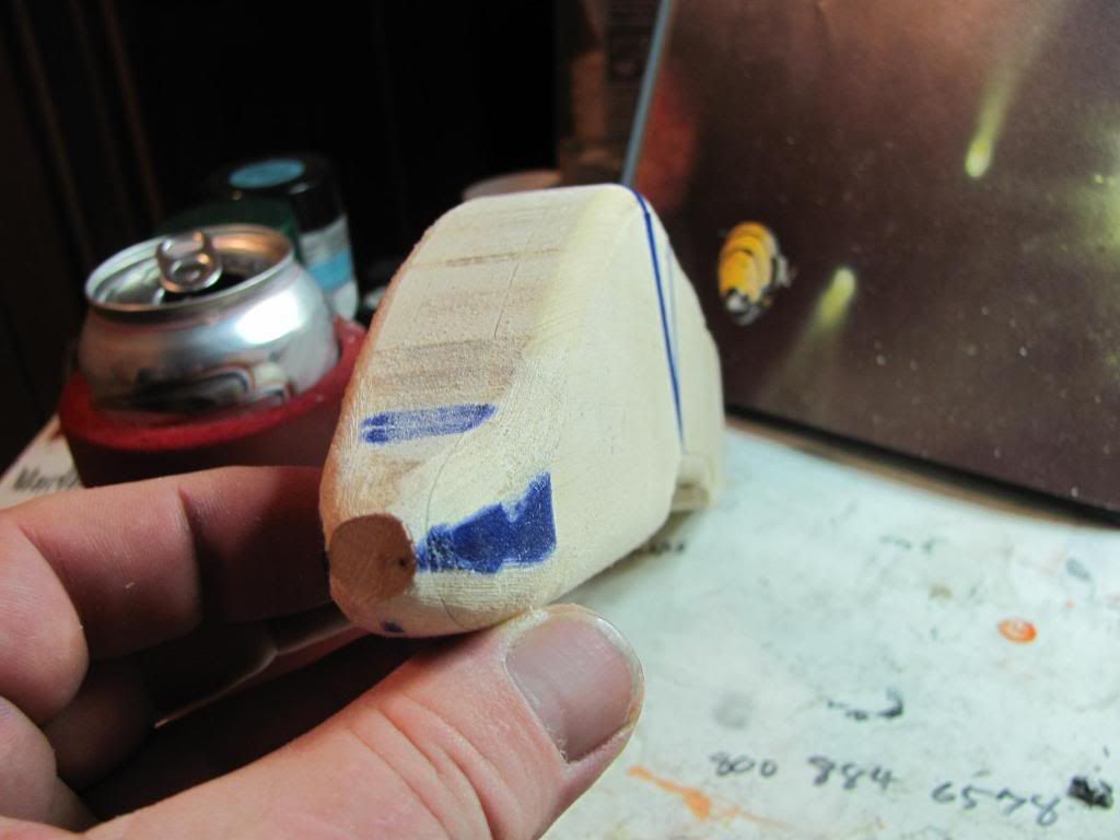

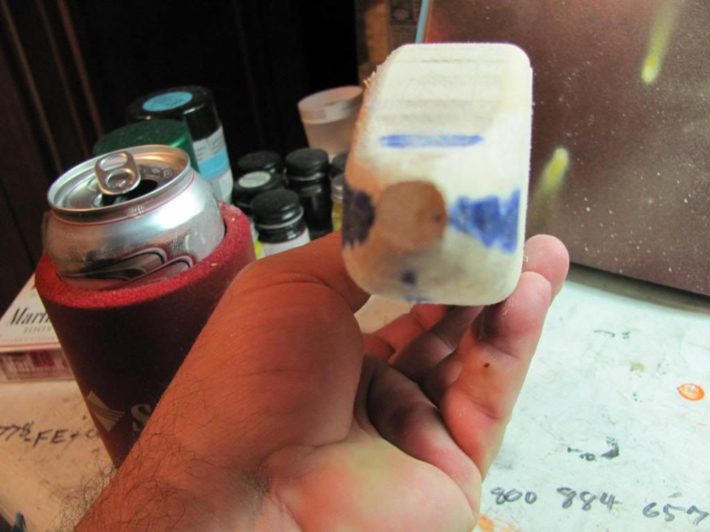

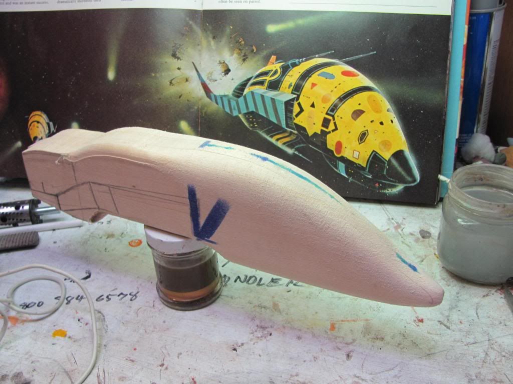

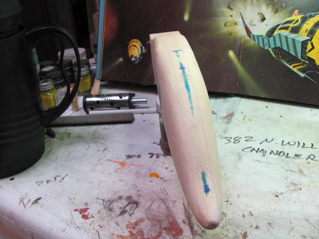

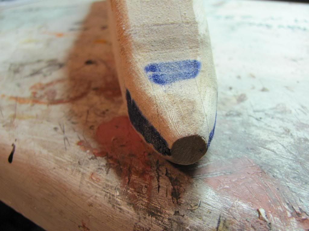

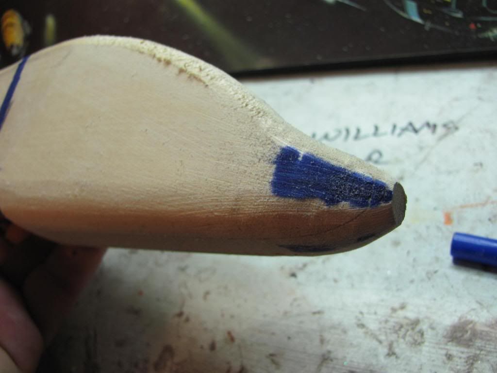

I see what your saying. I have built bows before so I am basically using the same method to accomplish this. I color the wood I wish to remove and then sand/grind/cut the colored material away then repeat til I get the contour I am looking for.
They also included this smaller pic in the illustration

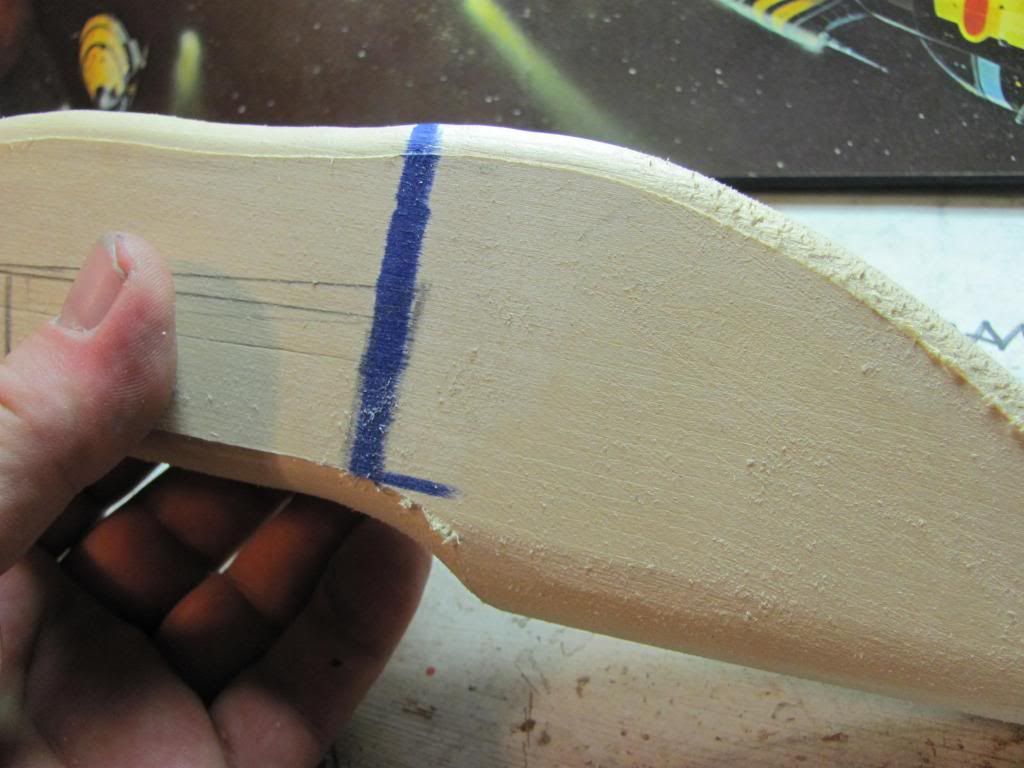

In that pic you can see that the bottom is smaller than the top so I have ground down the front sides
By coloring where I want to remove material I can keep everything even

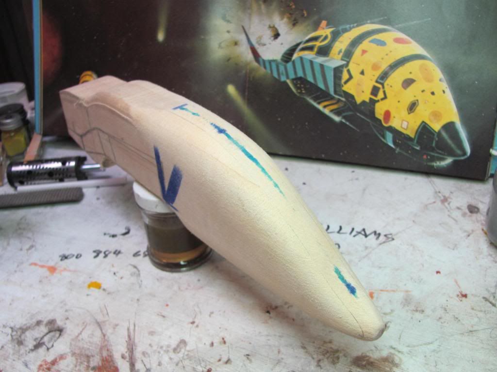

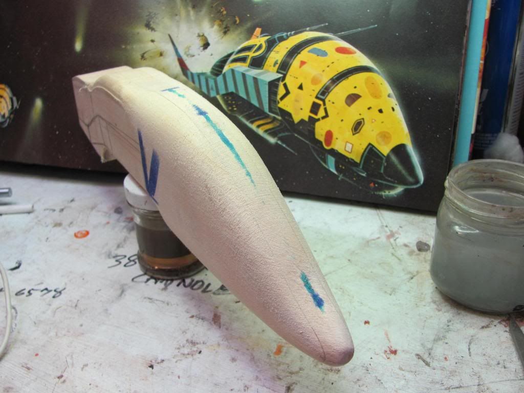

I hope so Baz :blink: I am already thinking I made it either too tall or not fat enough :banghead:
I definitely think it needs to be rounder in cross section. I am going to round off the bottom some more but I think I am going to have to furr out the sides with putty as they are too flat.
Possibly more pear shaped? The part under the nose looks to me as if it is added on rather than actually part of the main structure which could be a help.
