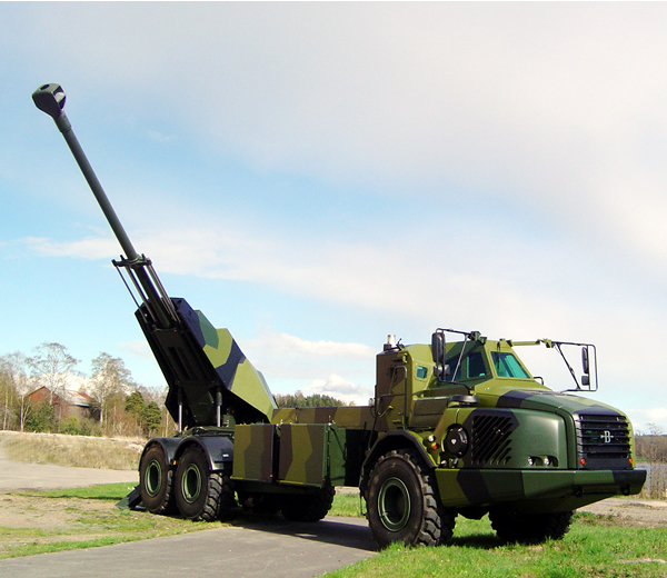

At the big end of the scale, there's the Bofors Archer, which has a seriously armoured cab and an autoloader:
I wonder what's the smallest truck you could mount the Royal Ordnance L118 105mm light gun on?
