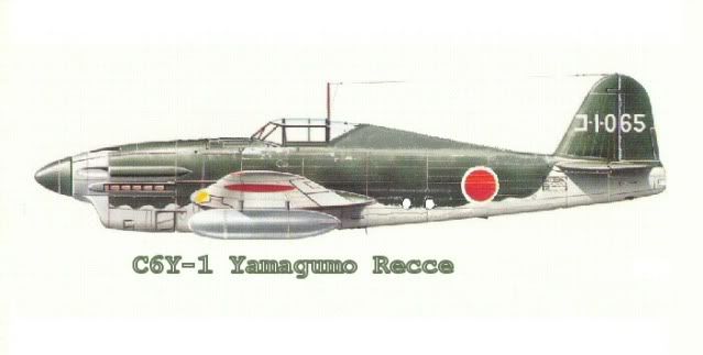

The illustration below is a doctored boxtop drawing. It's look is close to what I have in mind, but the color will be typical early-war IJN light gray, with low-viz markings, and the canopy will end in a semi-bubble instead of the "turtleback".

Sounds interesting.  One question: is the "Reece" on the artwork a hypothetical Allied call name or a mis-spelling of "Recce"?
Looking forward to this! Great profile. I like the Judy too, both radial and inline  :cheers:
#3
>One question: is the "Reece" on the artwork a hypothetical Allied call name or a mis-spelling of "Recce"?<
A mis-spelling of "recce".
MY GOD! For fifty-some years I have mis-spelled and mis-pronounced this word! To tell you the truth, I have never heard it spoken. I always had thought it had a long "e" sound with a soft "c" at the end, as if rhyming with "geese".
I looked it up in the dictionary on the prod of your post, and....it is pronounced "WRECK-ee" and spelled as you had it. Sheesh! Well, me larned sumpn' today! I have now edited my post to reflect my newly-acquired education.
I was momentarily deeply embarrassed, but THANK YOU for shaking out of my ignorance.
As far as the profile goes, I may have a hard time "correcting" the spelling, due to the fickle nature of my art program, but I will try.

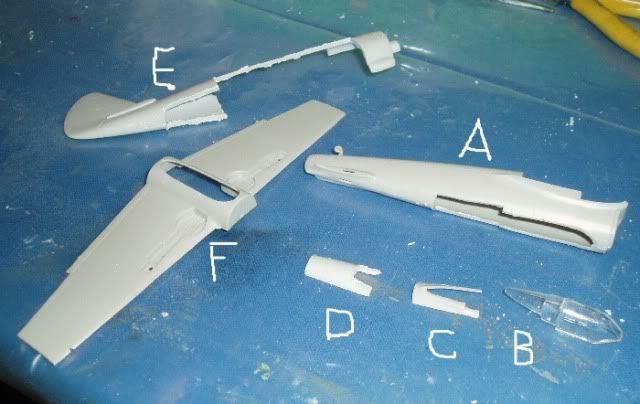

Here below are the components that I hashed out to fulfill the "single-seater Judy" concept in plastic. I had thought of moving the pilot's position slightly aft (as I had done for the profile) but instead kept it where it was originally, and just eliminated the G.I.B.'s position [A]. I wanted to keep the Suisei's canopy look as much as possible. When I first conceived the craft, that was the case, but when I photoshopped the color profile, it had a "turtleback" instead because that was the easiest thing to do with the Photoshop-type program I had. I like the semi-bubble I came up with for the actual model. I cut off the pilot's canopy from the regular Suisei, and experimented with where I should cut back the GIB position (B).
Moving the rear part of the canopy up, it didn't match, and I had a big, empty space there. I *CAREFULLY* cut the support for the rear of the canopy, re-shaped it a bit [C], and then needed something to fill in the gap. Looking to my Northrop N3B [E] that I had hacked up for the (upcoming) Super-Judy, I noticed that the rear fuselage seemed to have the same tapers and thickness. AHA! So I cut out a piece and shaped it (not entirely done with that yet--needs a bit of finishing work) [D].
Also, my concept for a semi-recessed fuel tank turned out easier than I thought (now THERE'S a switch!), so I made the tapered-oval bay in the bottom of the Judy's wing part [F]. It will look much like the color profile's wing drop tank if only you "painted" the fuselage over the top and middle of the drop tank (see three photos below).

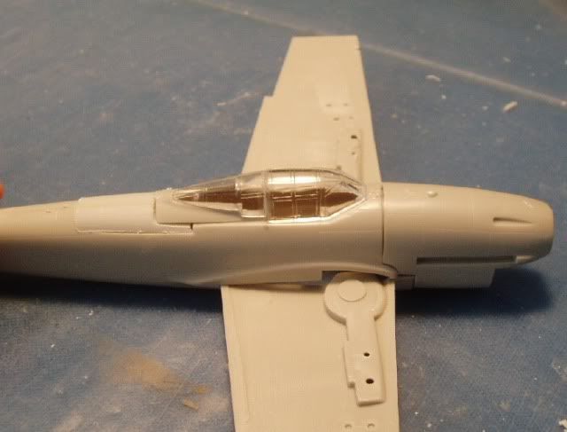

So here is what the cockpit area looks like dry-fitted together and before making minor adjustments:

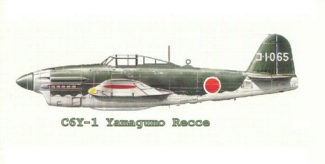

Now here is another doctored version, with the canopy/fuel mods, but remember that the final product will be in light gray:
