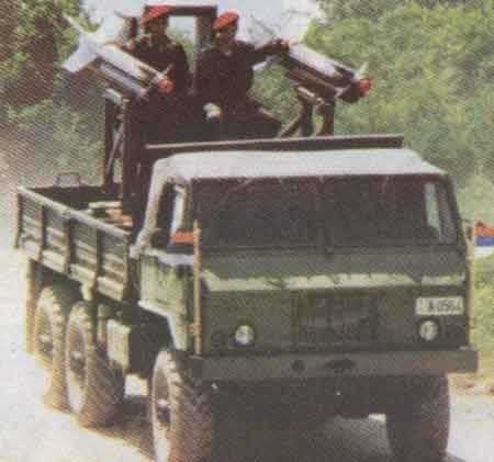

What if I took my trusty Zil 131 truck and put these two B8M1 80mm rocket launchers on the truck bed?  :wacko:

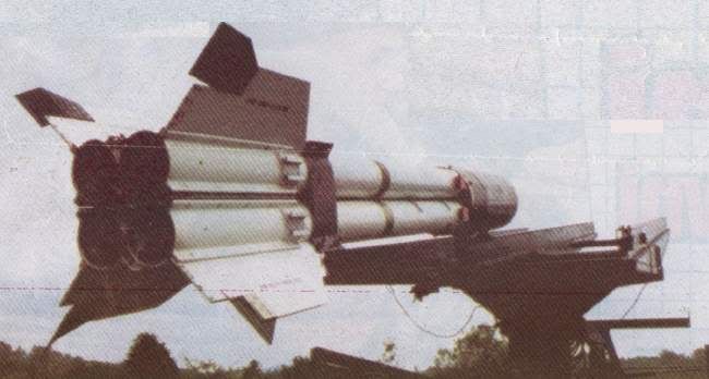

If I read the accompanying text right, this little number is four K-13 (AA2-Atoll) rocket motors with a 250kg bomb strapped to the front of them.... :o :o :o :o
Not only do I not want to be in front of that, but I don't want to be behind it either, or, indeed anywhere within a mile of it when it's fired..... what do you think the chances are of those four mass-produced, unmatched rocket motors all firing at the same time with exactly the same thrust?  :blink:
And look at the amount of offset on those four boilerplate fins! That thing's going to spin like crazy when it gets moving, presumably for 'stability'. [The word 'stability' here is used in its widest possible sense.........]
Steel Penguin
that just screams "light the blue touch paper and run"  or more likely get a poor private to do so  :blink:
I'd want a blue touch-paper so long that the war would be over by the time it got to the rocket......
Silver Fox
It should actually be pretty tolerant of mismatched thrust and pretty stable. You see, the fins aren't fixed, they're hinged and gyro-stabilized like a Sidewinder or Atoll missile. Wouldn't be all that accurate... should be a pretty wild flight though! Something that big wandering through the sky like a Sidewinder would be spectacular.

That's what I thought at first, but if you look at them:
a) there are no signs of the usual rolleron wheels in the control flaps,
b) at least one of them is pointing upwards, which implies that it's been fixed in position: the usual freely-hinged flap would fall downwards at rest.
In any case, the Sidewinder rollerons don't actually make the missile fly straight or follow it's characteristic "sidewinding" path. All they do is control the roll rate: the "sidewinding" iwas caused by the simplified guidance logic in the early versions which caused them to constantly over-steer.
That is rather reminiscent of the Japanese bomb rockets used towards the end of WWII.  Big powder rockets attached to small bombs and fired from fairly primitive troughs.   They worked reasonably well but weren't intended to be super accurate and neither is this, I suspect.  The canted fins impart spin and that would more than likely be sufficient to offset any imbalance in the burning of the separate rocket motors.  The CEP might be several tens of metres but its not intended to be anything other than a general bombardment weapon in all likelihood.
Quote from: rickshaw on April 13, 2010, 07:48:37 AM
