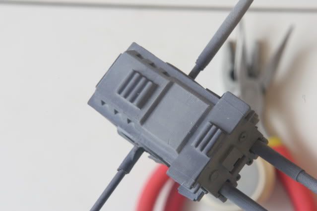

Here's a sort of before and after:
The underside of the AT-TS's turret was this colour before I started (this is the topside):
This is the underside after one coat of Slate Grey, about 50 secs drying time, and rubbing with a wet kitchen towel as recommended:
Since I wanted a "Star Wars Grey" look, this was too dark and too blueish, so I gave up on it at that point. However, if you wanted dark and blueish, it would be fine: it's not an unattractive result in it's own right.
