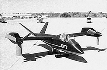

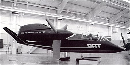

I take it this will end up being Russia's or the USSR's answer to the Bell Advanced Tilt Rotor (BAT) LHX proposal:
