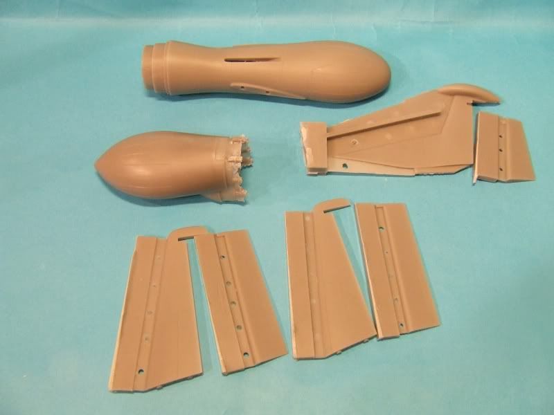

And finally the gorgeous Cammet conversion featuring a whole new tail including rudder and tailplanes as well as the radomes

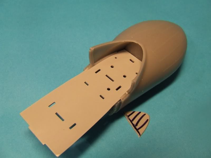

This is the cockpit floor.  The area marked needs to be removed to fit in the part for the nose

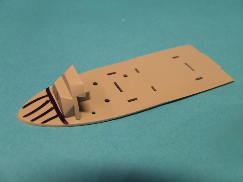

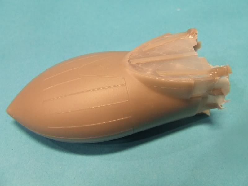

This is the aforementioned nose part, before it has been cleaned up.
This is the nose part cleaned up, with cockpit floor slid into the slots that Cammet kindly provide :)

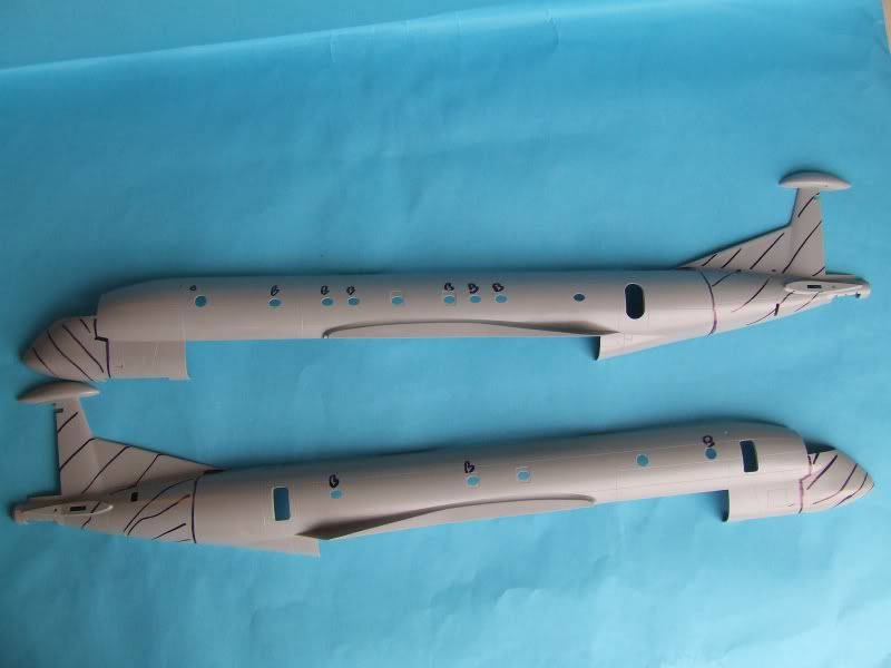

So far so good!  Lastly a pic of the fuselage halves, with the areas marked for removal.  The holes marked "B" need to be blanked off for the AEW version.
