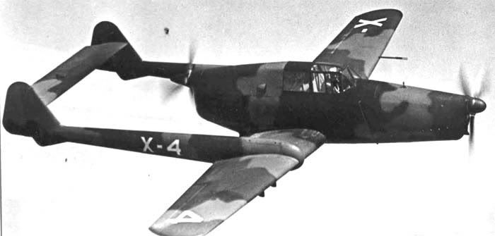

First, Fokker D.XXIII, push-pull fighter developed in The Netherlands in the late 1930's, first flew in 1939.  Only flew four hours of testing before Holland was invaded, so there was never a chance for this aircraft to be proven.  Some say that it was instrumental in inspiring the development of the Do.335, others point out that Dornier had already used tandem mounted engines on several of their flying boats.
A number of engines were slated, the Hispano-Suiza 12Xcrs, Junkers Jumo 210G and Rolls-Royce Kestrel X but the Walter Sagitta I-SR was selected, probably because it was indigenous & Hollands neutral stance at the time.  Rolls Royce Merlin, Daimler Benz DB.601 & Isotta Fraschini Delta were also proposed.

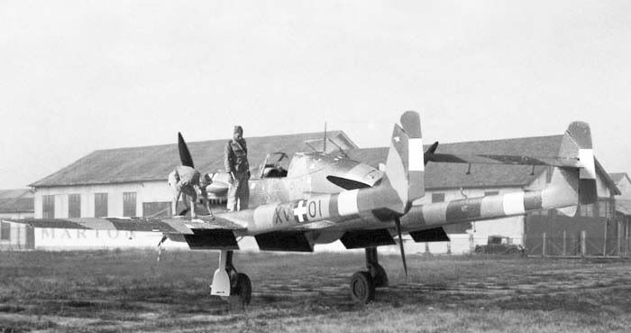

Next up, Marton X/V (also known as the Varga RMI-8).  Built in Hungary, it used two Daimler Benz DB.605's at 1475hp each.  It was very close in design to the Fokker D.XXIII, details differed such as the wing design, but the layout was very similar.  The main difference was in power output, the Marton X/V having nearly three times the power of the Fokker D.XXIII with two Walter Sagittas at 545hp each.
There is a 1/72 resin model by RS Models.

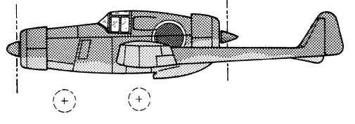

I realise the pic is an artists impressions, but a the ear intakes seem to be a way of increasing the air into the rear engine.  Probably not as important on a radial, but might have been away of increasing the airflow to the rear engine, something that Fokker found to be a problem.  I'd personaly site them lower or dorsally so you wouldn't have to remove the rear window & restrict vision.

Quote from: Mossie on November 27, 2009, 07:53:01 AM
Looks to me like those are aircooled, which means the most efficient way of getting cooling air in is an annular intake. Even then, the rear engine would sit downstream of the hot air coming from the front engine.
One way to increase cooling capacity in the Fokker would be Spitfire-style underwing radiators inboard of the booms. This also avoids airflow problems when the gear is down.

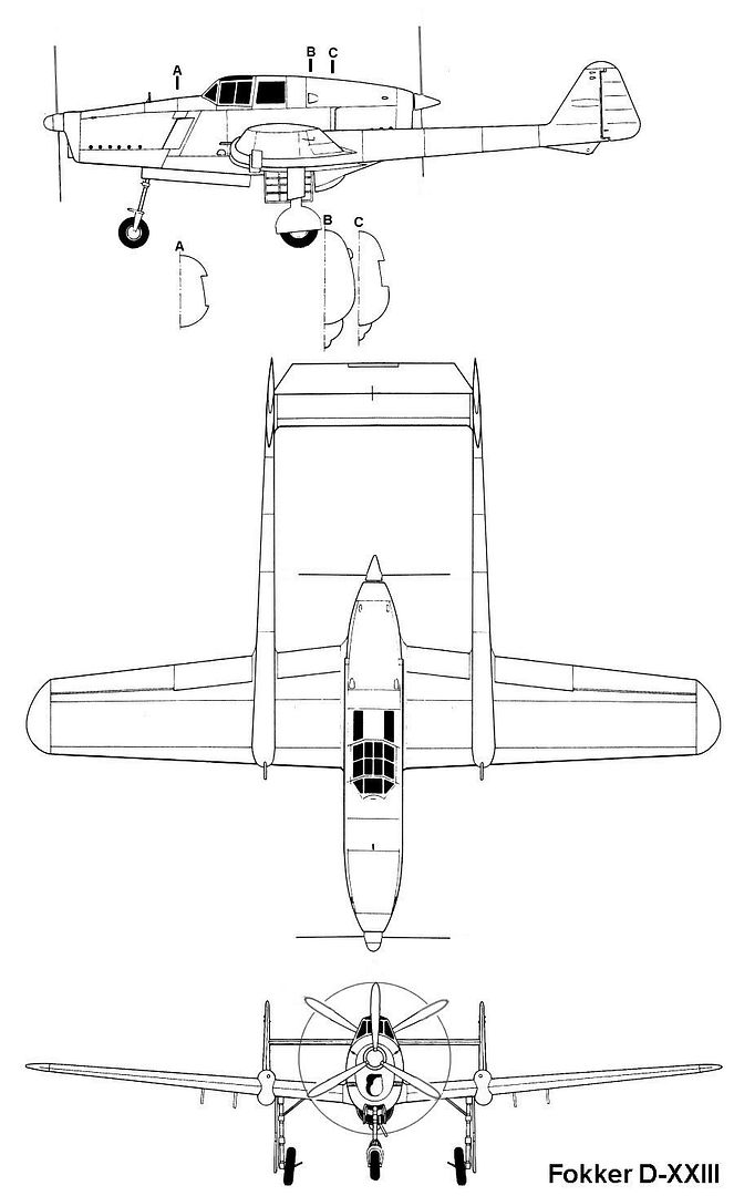

More detailed drawings of Fokker D-XXIII are here:
http://www.airwar.ru/other/draw2/fokd23.html

If I was going to improve cooling for the rear engine, I'd go with an underfuselage scoop to direct the cooling air directly at the finned cylinder heads (I believe the D.XXIII used aircooled engines comparable in configuration to US-built Ranger and Menasco engines).  The cowl opening for the forward engine is about as good an opening as you'd want for this engine configuration (aircooled IV-12).  Now, if you fit some good liquid-cooled engines front and back, a whole lot changes.
