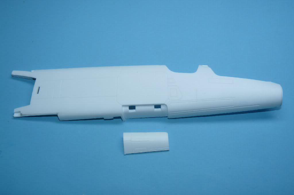

Hi chaps, following the madness that was SMW, I've decided that the time has come to grab the bull by the horns and finally build one of my 4 big TSR-2's!! particularly as I spent a fortune on after market bits for the kit and don't want to spend a lot of time sticking all my hard work on a dodo!!
We all know the horrendous cock up Airfix have made with this one regarding the forward fuselage and it's weird bulged look so I'm going to break out the hacksaw, sledgehammer, bandsaw and acetalene cutter and batter the thing into shape...this will also involve squaring the fuselage corners up as well as they are all too rounded... :banghead:
With the help of info gleaned from Campbell, (of Odds and ordnance who are doing the whole front end with integrated intakes in resin late next year), I am going to set about altering the thing as I couldn't wait that long!!!hope your uveitis clears up soon Campbell :thumbsup:)
First up is setting the model against a set of 1/48th plans ...where the extent of the problem becomes apparent!! the panel lines along the roof of the forward fuselage should be parallel not angled as on the kit.This is what gives it the bloated appearence when viewed from above, so it's a simple matter of cutting  out the long panel and reinforcing the sides with plastic strip.I found that the easiest way to do this was to cut the nose section off just ahead of the intakes and remove the roof section with an Olfa cutter.
This improves things no end but is really only the beginning of major surgery!!
The next problem is the underside floor section which now has to be narrowed the same way and flattened off as the kits profile is almost circular!!...Putting this section against the plans now shows the biggest problem!!.....the fuselage is too deep and needs drastic work to line it up parallel to the panel lines.
All this is very baffling because Airfix got it (almost) right with the 1/72nd version ironically started life as a 1/48th prototype!!), went off to China and came back looking 6 months pregnant...what on Earth happened, did they give the moulds to Trumpeters famous fantasy design team??
Even after all this is hacked into shape there lies one last major hurdle...all this surgery will leave an 8mm difference between the intake shroud and shock cone...put simply the intakes on the kit are too narrow and the cone too small....we'll cross that bridge when we come to it :banghead:

The forward section is removed just behind the intakes...the black line along the bottom fuselage is where the fuselage must be cut to match the plans...a lot of work will be needed to marry everything up to the mid fuselage area!
You can see in these pics  how much more accurate the 72nd fuselage is in comparison..
This really shows the problem...whilst the 72nd version has some bulge the larger kits is way over sized...
Best way to deal with the problem is to remove the top panel , bring in the sides and square off the panel before refitting....
The bottom now bows out alarmingly and will also need cutting back...
Whilst far from perfect it will require a lot less work now to flatten the sides to a more accurate profile...
TO BE CONTINUED !!!

This was the work done last night, things are progressing apace..
You get some idea of the incorrect taper from this.The panel lines should be virtually parallel!!
After a few minutes of fettling, all in place and braced underneath with square section plasti-rod and filler....you can see the bulge still present on the underside which will be dealt with next....
Clearly, Field Marshal Haig is about to make yet another gargantuan effort to move his drinks cabinet six inches closer to Berlin.
General Melchet
#8
Next step, attack the underside. Same problem as the top...the sides need drawing in and the underside panelling flattening off..Firstly I cut the large lower wraparound panel in half as it will no longer fit once the sides are sanded back. These are then glued into place and sanded until even. About 6mm on each side just behind the nose gear bay must be removed to ensure that the panel fits snugly and gives the underside a more accentuated edge.
You now notice that the undercarriage bay sides need cutting back and squaring off so that the bay fits properly....all good fun innit!! :hobbyhorse:
We are now getting somewhere!!
The lower bulge has now gone and the whole thing is looking more like the real deal............
The top panel will be sanded to shape once everything is in place...
The underside rear panel will be blended into the fuselage sides to give it the correct shape...
This shows the work needed on the undercarriage recess, just a case of squaring it all up.
