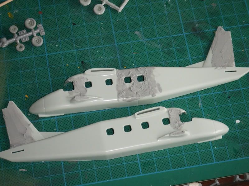

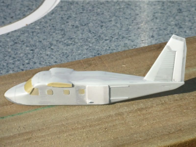

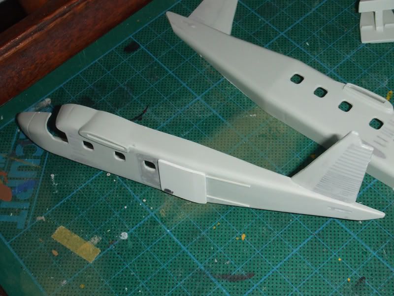

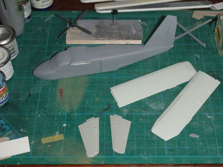

First to be attacked was the fuselage.
Glue the two door halves in place, then fill them in with putty, also the 'corrugated' effect either side of the cockpit, and the fin.
Cut off and fill the bits for the kit undercarriage/engine mountings.
PSR,PSR,PSR.

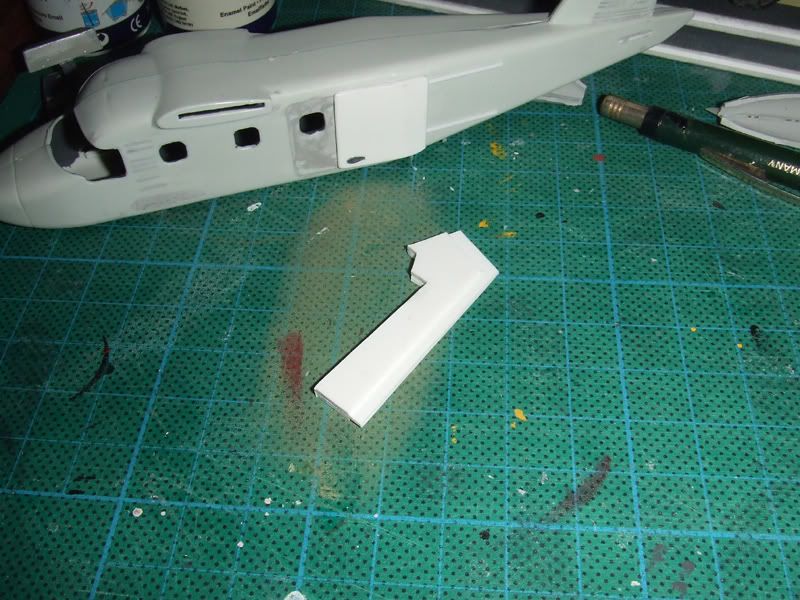

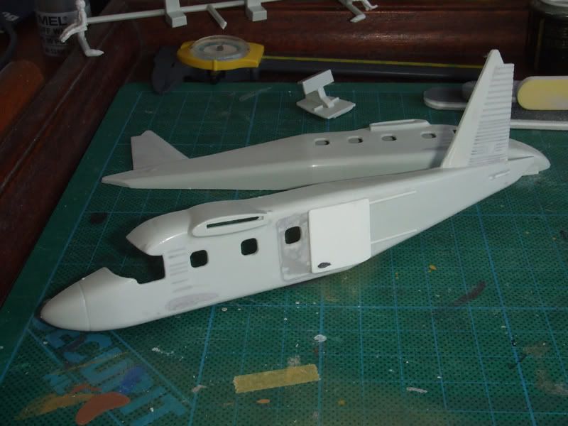

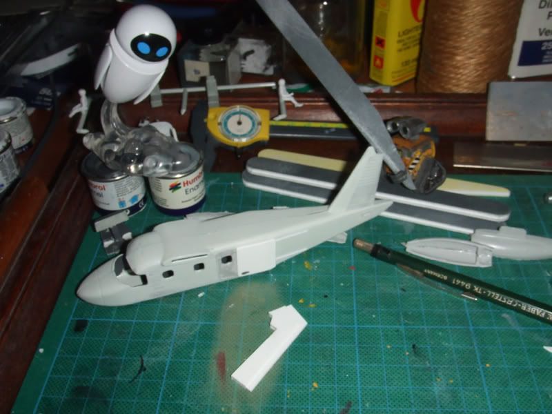

Next was the new sliding door and it's rails. This was so that the aircraft would be able to airdrop stuff, the original doors opened like a pair of French windows, and could not be opened in flight.

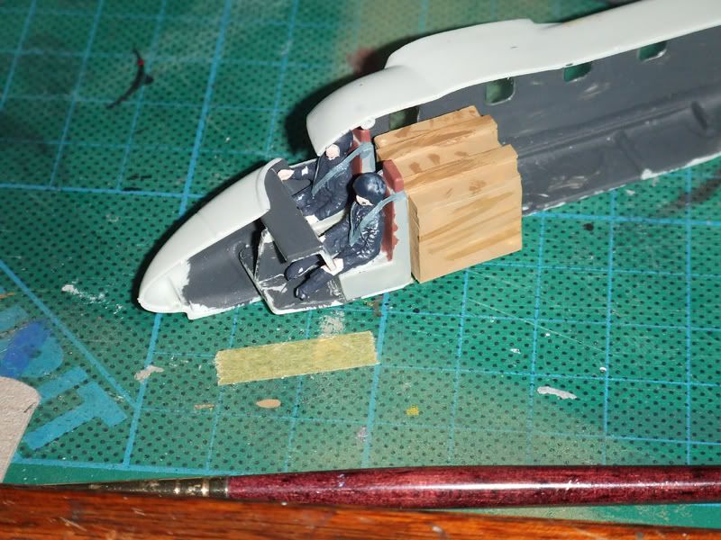

Then it was time for the cockpit interior. Two military pilots, and the instrument panel painted up to represent a glass cockpit.

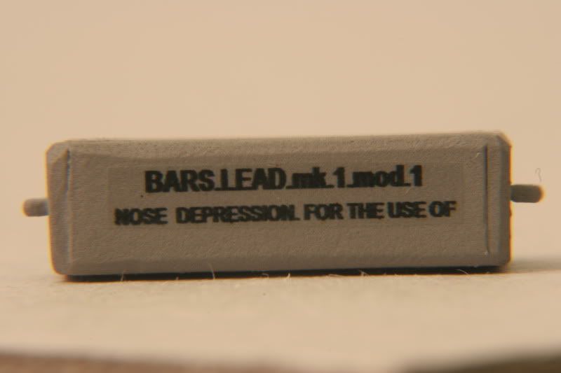

Also, extra nose weight was added by building a box of plasticard, filling it with lead shot, and painting it to look like a wooden crate.

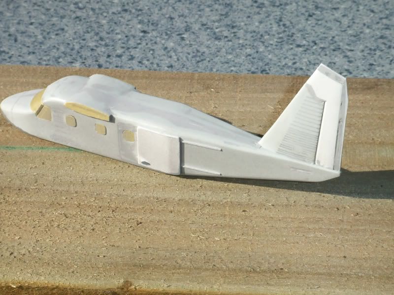

Next , the fuselage was glued up and left to set, while the new fin and rudder was created from plasticard and putty.
The shape closely mirrors that of the Su-27 'Flanker'
Once that was in place, and had set.
More PSR, PSR, PSR.

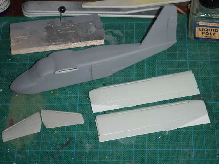

Then it is primer, and PSR, etc for the fuselage while attention is turned to the wings and tailplanes.

Must say that this :
Quote from: JayBee on August 11, 2009, 09:30:04 AM
is a very good trick to sort out a tailsitter, well done!

Oh, I agree...... ;) (I should point out that JayBee had the idea independently and first.)
It's a great project JayBee: looking forward to the end result!  :thumbsup:
[/quote]
Who knows who was first, BUT I certainly lost out in the competition for the humorous stencilling. I bow to the master.:bow:

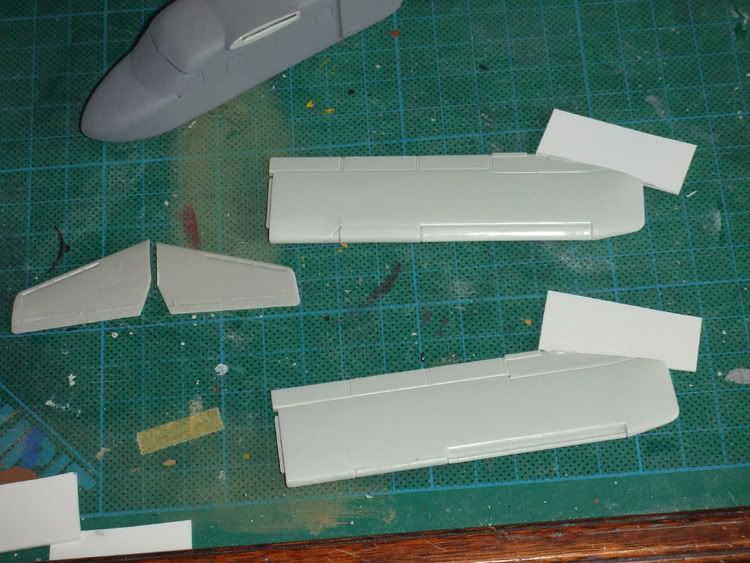

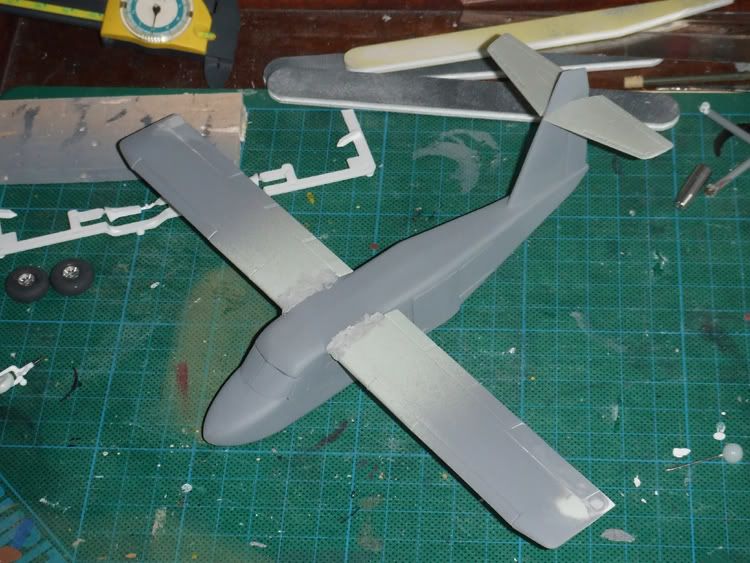

Next was the wings and tailplane.
The tailplane is an all-flying tail and has fixed inverted slots on the leading edge, like late Phantoms had. This is to prevent tailplane stall when in super STOL mode.
For this I used the wings from a Tamiya 1/100 scale Me-163B Komet, reshaped slightly, and mounted upside down.
Then I decided that the wingtips needed changeing. I had a lot of different ideas for this area but in the end decided to just extend the trailing edge to make the wing look more regular.
This was done by cutting a slot into the kit trailing edge with a saw and glueing in a piece oc plasticard. When dry, this was trimmed to shape, then it was PSR time again.
Woah...does that ever change the look !

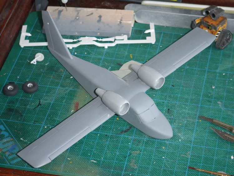

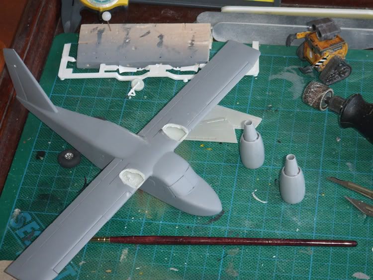

So far it looks like it is a glider, so we need engines.
These came from a Hasegawa, 1/200 scale, Tristar.
My original plan was to trim the pylons to fit, and mount them over-wing, but the shape of the front of the cowlings did not look right.
So after a bit of thought, and searching Airliners.net (link: http://www.airliners.net/photo/Russia---Air/Antonov-An-72P/1419556/L/&sid=238b507f5aa8c465395eec8e6d9890b2) this is where I got to.
I had to sand a lot more out of that wing than I had expected to! :o
Thank you mister DREMEL.
Dayummmnnn, that's cool! :o :thumbsup:
It gets even cooler (I had a sneak peek  :thumbsup:)

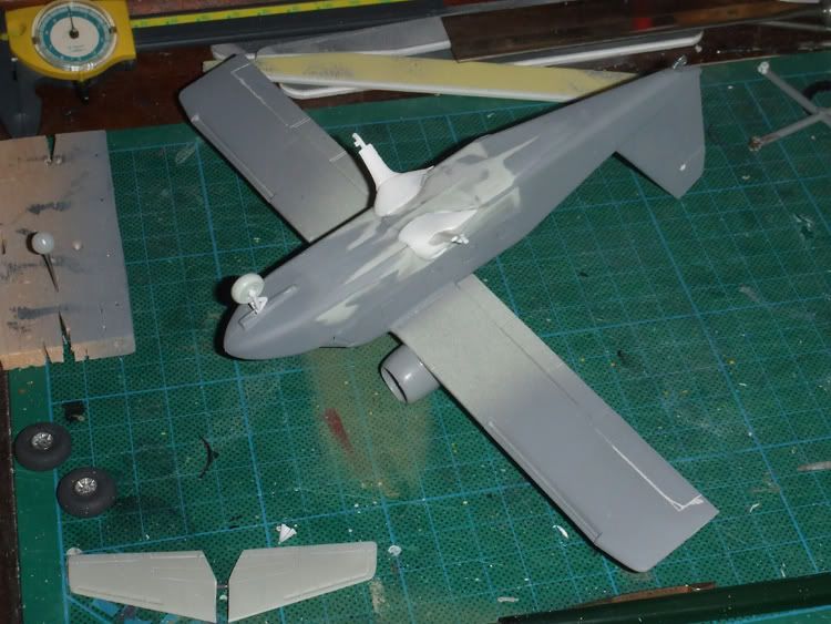

I used the undercarriage from a Matchbox Twin otter. At first I planned just to glue the u/c main legs directly on to the lower fuselage sides, but as soon as I had done the first one, I realised that there would be insufficient ground clearance for the aircraft to rotate when doing a really short T/O.
So I had to use the fairings from the Twotter.
This almost ended the project as the fuselage cross-sections of the Twotter and Do-28 are WAY different.
This meant that there was a lot of reshaping, carving, sanding, and ultimately PSR, LOTS of PSR.
In the end, I persevered and ended up with this.
