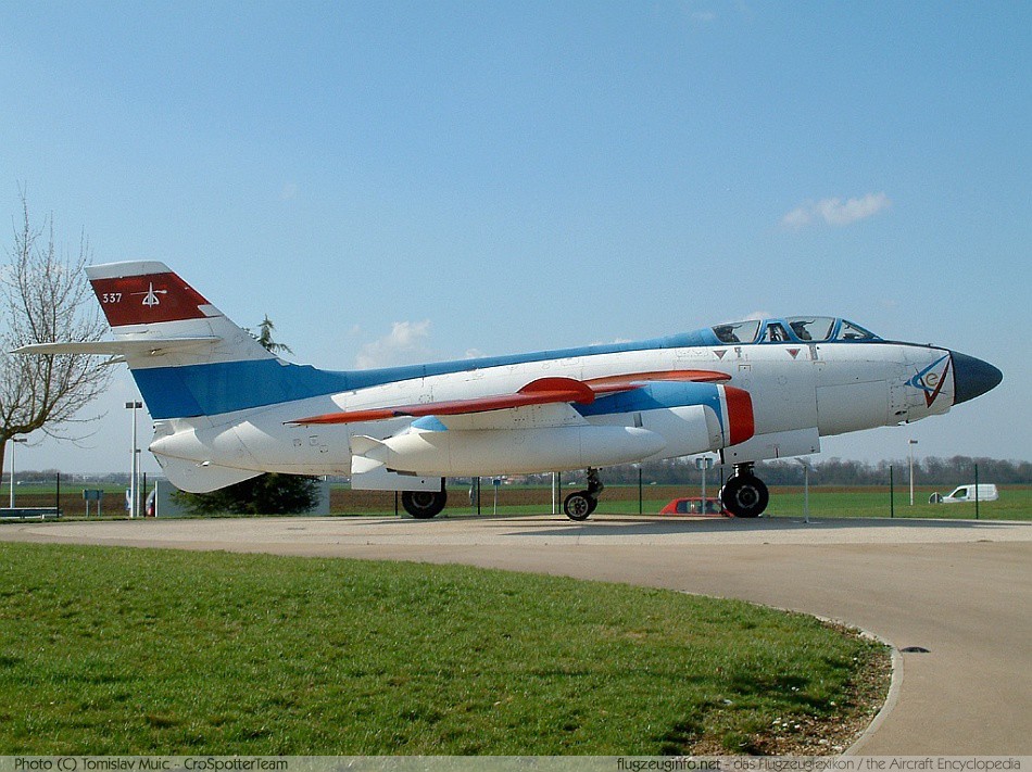

The Vautour is another example of a layout similar to the B-47, XB-48 etc.

Thanks for the thoughts guys. I knew about the XB-48 and I assumed it levitated like a B-47, and I've seen a Vautour fly myself, and it does the same. I'd forgotten about the Bison, it seems to follow the B-47 setup with two large bogies spread equally around the CG.
