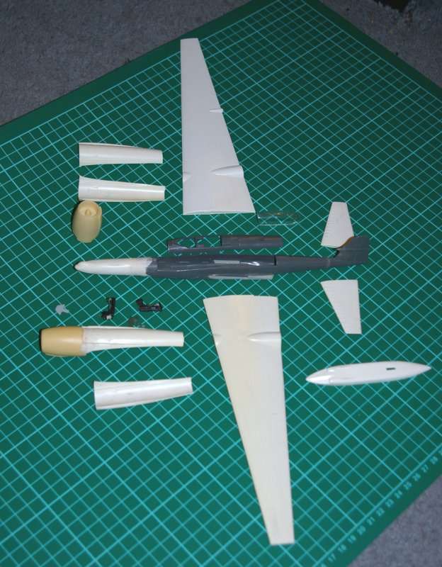

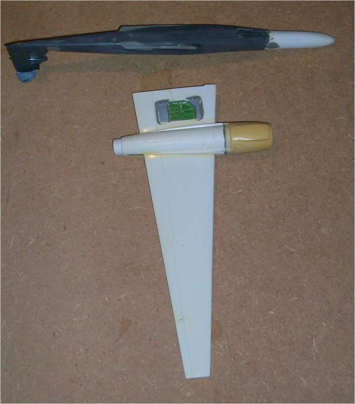

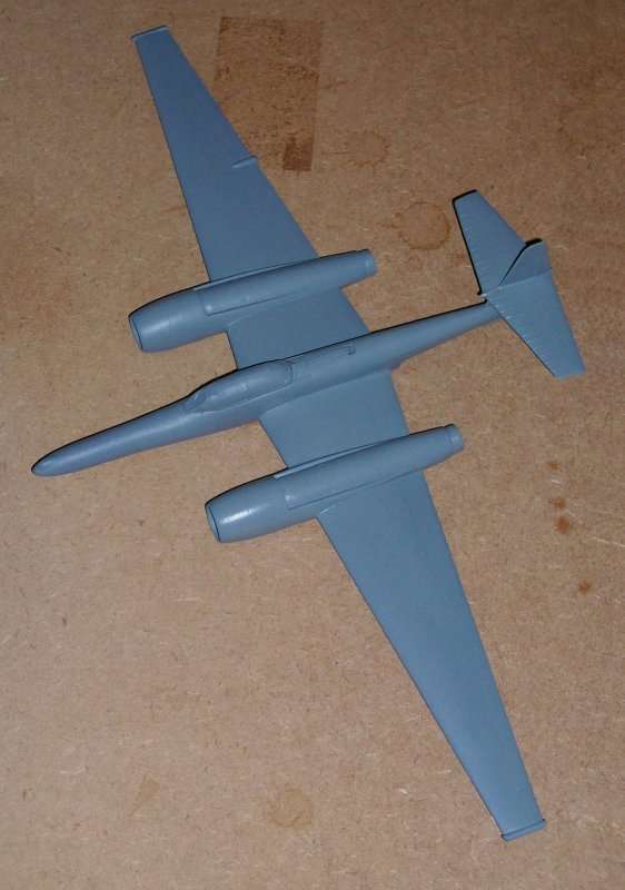

Just to show that I don't spend all my time making lists of stuff to sell, or making pedantic remarks about bizarre aviation projects, here's a couple of shots of my Meteor PR19b in build.
GA of the build. You can see the ex-Rareplanes vacform TR-1 wings and tailplane, together with the resin engine fronts and vacform cowlings from the DB RB-57F. The recce pod from a Matchbox Phantom is also in view, plus a few bits and pieces for the cockpit.
Close-up of the front end. The nose is the ASARS-2 nose pod from the TR-1, but if you've read the story you'll know all about that of course.  :lol:

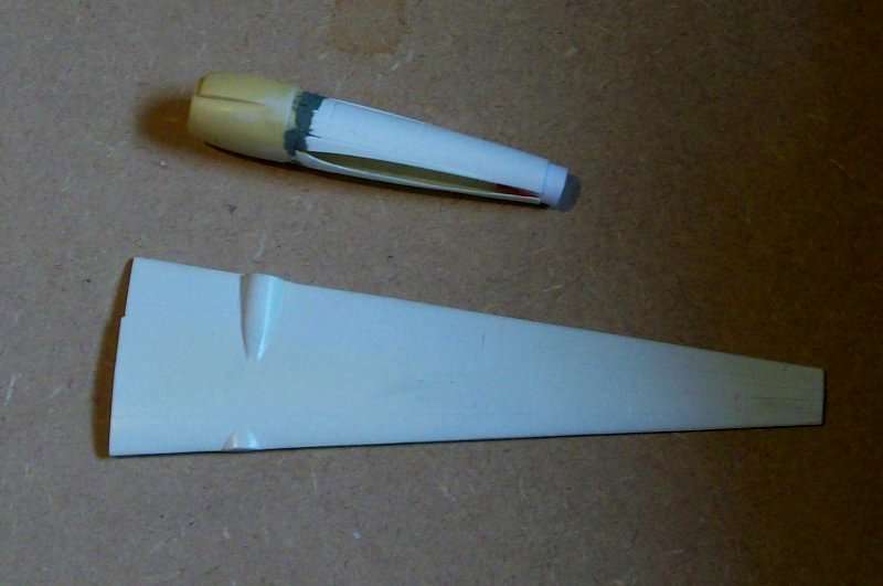

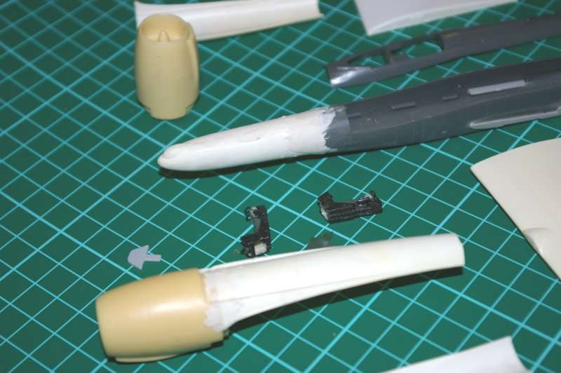

The wings of the PR19b are Rareplanes TR1 vacforms and have the Super-pod fairings moulded into the upper halves of the wings. Luckily these are just about the right distance apart for the new larger engines I wanted to fit and equally luckily the vacform TF33s that I'm using, from the DB Models RB-57F conversion, are large enough to completely enclose the Super-pod fairings.  ;D

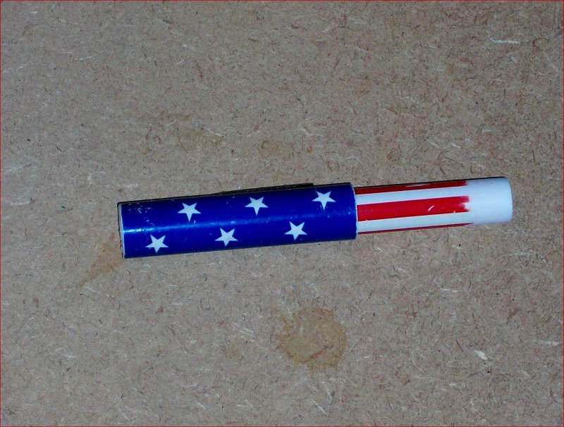

The TF33 engine exhausts on the DB conmversion aren't that impressive so I used two off-cuts from the cap of a handy roller-ball pen. As they're meant to be American engines I used an American pen cap.....;D After the engine halves had been sandwiched around the Super-pods and the exhausts, the resin intakes fitted nicely on the front and then I filled in the resulting LARGE gaps with Milliput and started a mammoth PSR session to smooth it all out. I used many coats of Halfords Grey Primer at this stage, so much so that I had to go and buy another tin!

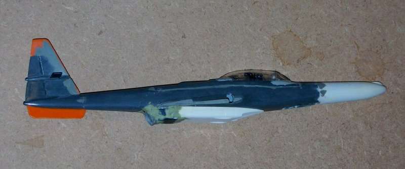

Attaching the wings to the fuselage wasn't easy, and I pre-engineered the joint before doing the cockpit and priming the fuselage. On the PR19a I used the entire inner wing and main engine section from the M'box kit so the joint was as strong as the original, but using vacform wings required some hefty re-inforcement. I used a thin section of the M'box inner wings to provide a smooth fairing but otherwise cut off the whole inner wing, then drilled two 5 mm holes in the wing root which were aligned with the front edges of the landing gear bays mounted in the wings. Then I made up a 3 layer 20 thou styrene spar which was notched at its outer ends to fit around and above the landing gear bays. Much fiddling and measuring was needed to get the fit correct, complicated by the need to give the wing a slight anhedral angle of about 2.5 deg. before I firmly super-glued the spar in place across the fuselage.

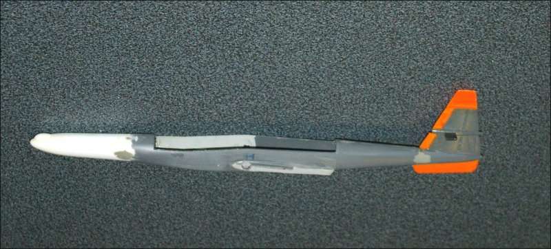

Then I did the cockpit, adding some Aeroclub bang seats and a few other random bits and pieces, making sure it wasn't quite the same as the PR19a interior as it was meant to be an upgrade of course. Adding the upper fuselage decking was the usual M'box Meteor NF14 disaster, needing LOTS of sanding and PSR work before the joint vanished. I added the canopy at this stage and masked it up before any paint work was done. I'd updated my PR19 drawings a few years ago and to match those I enlarged the fin and rudder a bit, as well as lengthened the tailplane fairing to match the TR1 tailplane halves, which had their own small spar fitted through the fin.
The backstory has the PR19b fitted with a large rocket motor in the rear end of the underfuselage recce pod and I used another chunk of the pen cap to model its exhaust, but it needed yet more PSR work to make it blend into the rest of the fuselage.
