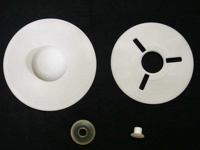

Here are the parts:

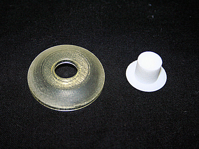

I used their SLS printer for the white bits and the Objet printer for the clear engine dome. The SLS printer produces a rough but very tough surface, the Objet produces a smoother and clear part. You can see the differences in the lower dome and footpad:
This means that the SLS parts would require quite a bit of PSR (mostly P) to smooth out; the Objet a bit less. The SLS printer is also limited to a 0.5mm minimum part or detail size, so that could be an issue with smaller or more detailed models.

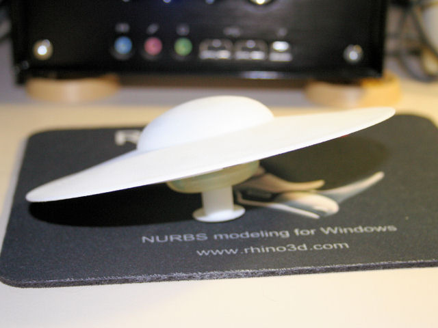

Here's the C57 tacked together:
I'm redoing this model to make assembly easier, add the stairs and I'll have it printer in a higher/better resolution. It's not Scratchbuilding As We Know It, but pretty close. It's certainly not easier...

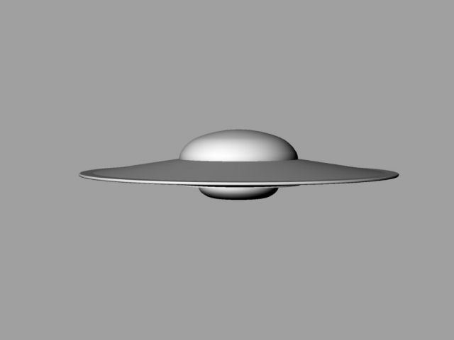

And here's a render of the original model; you can see that it's smooth:
