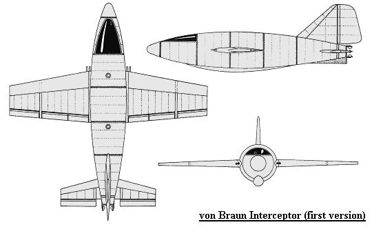

Basically like the Von Braun Interceptor(see here: http://www.luft46.com/misc/vbi.html)
