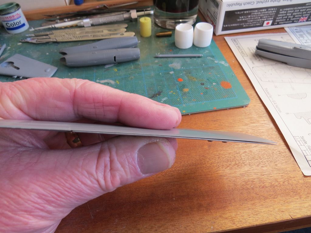

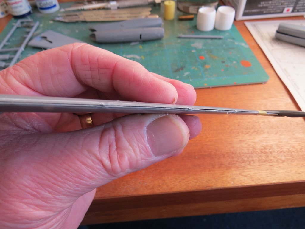

Right at the beginning of the build a problem has arisen with the kit, the wings. The upper and lower surfaces do not fit together very well in that there are serious gaps between the upper and lower surfaces at the leading edge and trailing edge.
I have already decided how I am going to tackle this. This is not to be a model to serious competition standard, in fact it is a WhatIf, so I am just going to squidge some filler into the gaps, tidy them up a bit, and Hey Presto!
Is there something protruding up like a mold defect? Doesn't take much of a high spot to produce a gap.
If JayBee's Mandrake is anything like mine the wing moulding itself is warped chordwise and convexly, so the LE and TE have no chance of meeting each other.
I never finished mine (Wow, what a surprise....) but I think I did the 'hot water and bending' trick to sort it out. A Model's styrene seems quite amenable to such treatment I'm pleased to say.

For Kit's benefit the wings in my model are pretty straight. It is just the design of the mould that is the cause of the problem.
If anyone wants to make an accurate model of a Mandrake they have quite a job on their hands.

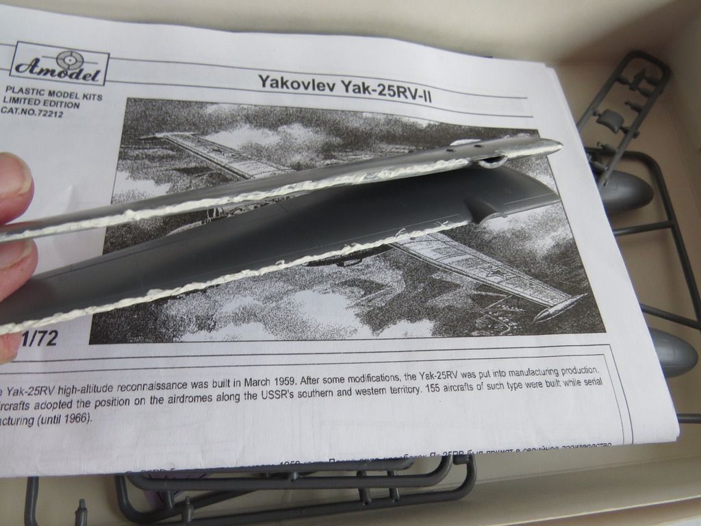

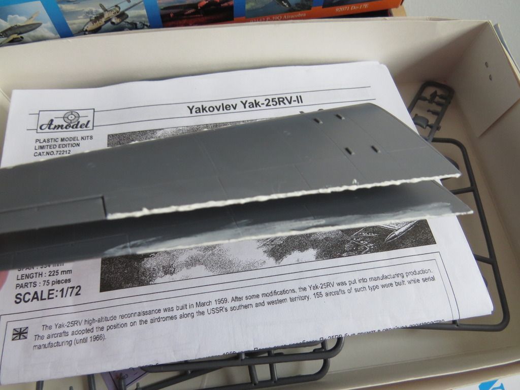

The Wing LE's and TE's have now been filled prior to PSR. For this I used Vallejo acrylic filler which comes in a tube with a wonderfully thin nozzle for applying.
Also being Acrylic it is water soluble so a damp finger can be used to smooth it a bit. In this case I just licked my finger. You should be able to tell which bit I did that way and which I have left for normal PSR.
The licked finger method is good but you do have quite a time of it cleaning your finger afterwords!
