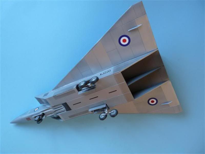

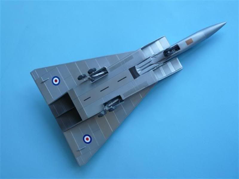

The model is built mainly of the following ,
Body and engines and tail, 5 sizes of Evergreen Plasticard, plastic rod, brass rod and white metal,
Cockpit , ICM MIG 31  foxhound , cockpit area Revell X15,
Undercarriage , white metal TSR 2,
Wheels True Detail 1/48th P80 ( nose) and 1/48th Skyraider ( main),
and the afterburners also come from the ICM MIG 31  Foxhound.
Cockpit glazing courtesy of Humbrol Clear fix.
Construction started with the wings which were built up from 2 ply of Plasticard with a strengthening triangle  section inside , then sanded to shape and scribed ( as was the whole airframe ,this was a royal pain in the ar #$ !!!!). Next came the fuselage /engine sides ,same again only this time one layer of card leading edges were all shaped. Room had to be made for the engine bays and U/C and variable air inlet ramps constructed. Engine turbine faces were used from a spare Academy SU27 ( though you can hardly see these !!).the pictures show it better than I can explain so I'll cut the waffle . The cockpit was tricky but in the end I opted for the ICM MIG 31 as the profile fitted perfectly and as luck would have it I had one knocking around , so I butchered it .!!.After filling the top side I needed a whole new cockpit , looking at the pics myself and Thorvic decided that the old Revell X-15 kit would be a suitable donor, and guess what , I happened to have an old one in the loft !!. After quite  bit of fettling I got it to fit, all I had to do now was add new side windows with my Dremel. The undercarriage was also a bit of a poser , in the end the obvious choice was TSR-2 but I couldn't bring myself to use the Airfix ones, fortune smiled on me and Chris (Falcon) kindly gave me a set of white metal ones he had at the Coventry show .I didn't use much filler as I knew it would have a NMF so I kept that down to a minimum (thus doubling the build time !!!) The wheels were courtesy of Hannants, (True Detail sets for P80 shooting star and Skyraider, low pressure filled with nitrogen was envisaged).
The whole thing was primed in Alclad gloss black and airbrushed with EVERY shade of Alcad 2 I had ( which was pretty much the whole range !!!).
The decals were from a number of sources , mainly Modeldecal , Xtradecal, and silver, dark grey stripes and solid block. The serial XJ220 was chosen from a cancelled Swift order , the date being correct for the estimated time frame  :analintruder:

The final product , took a bit of work but I got there , what's next ??!!

EXCELLENT!   That is beautiful.  Scratchbuilt and NMF, that is impressive.

I tumble out of bed on a nice sunny morning, start brewing up a good cup of tea, and get greeted by this. Life is wonderful!  :thumbsup: :bow:
looks great, you truly mastered Putty FU there  :wub:
i just love that metal finish  :thumbsup:

Nils, putty, wet and dry and lots of water....yummy....staple diet of the scratch builder!! ;D
