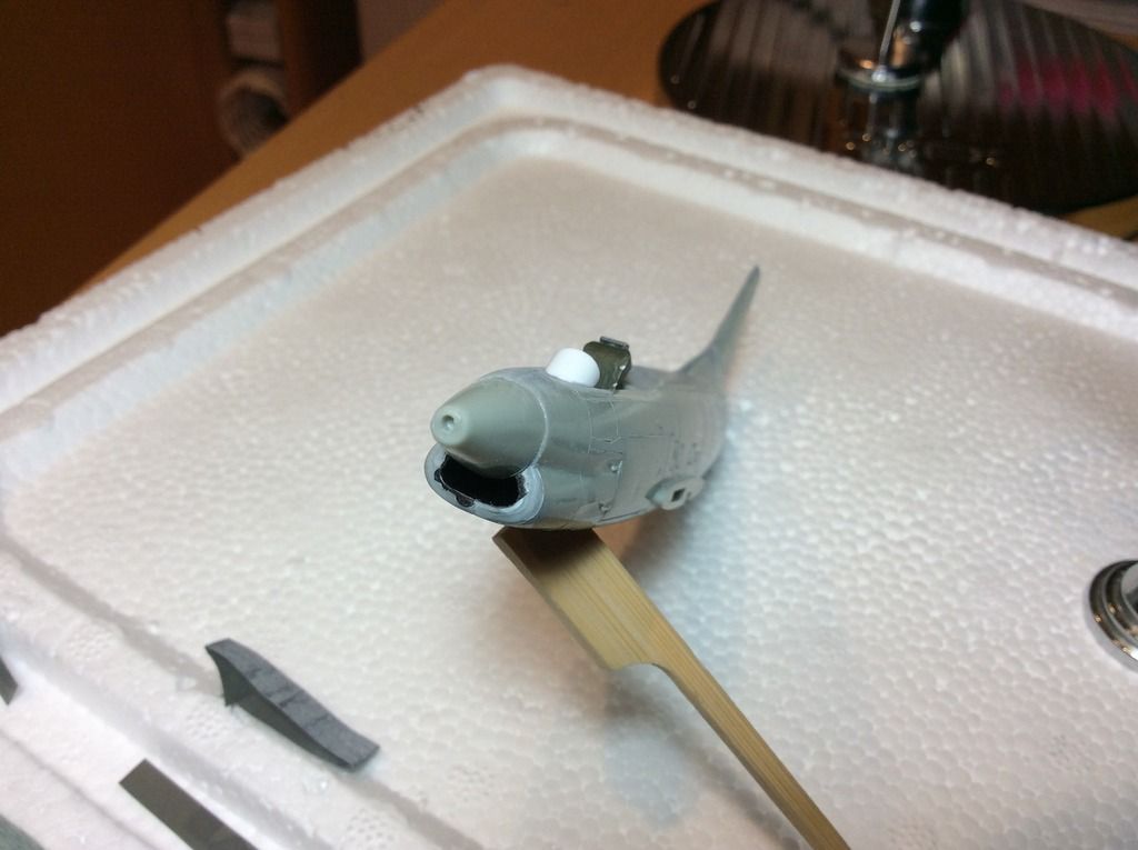

Ok, so all the guts are in place and I stitched up the fuselage.  I also cut off that weird little nobby thing above the control panel and replaced it with a bit of tubing cut at an angle.
And, from the back...
A bit of sanding on the inside of the air intake to cover over that notch, and some more dark metallic grey, and we're good to add the nose cone.
Ok... what's next? Why, PSR of course!
