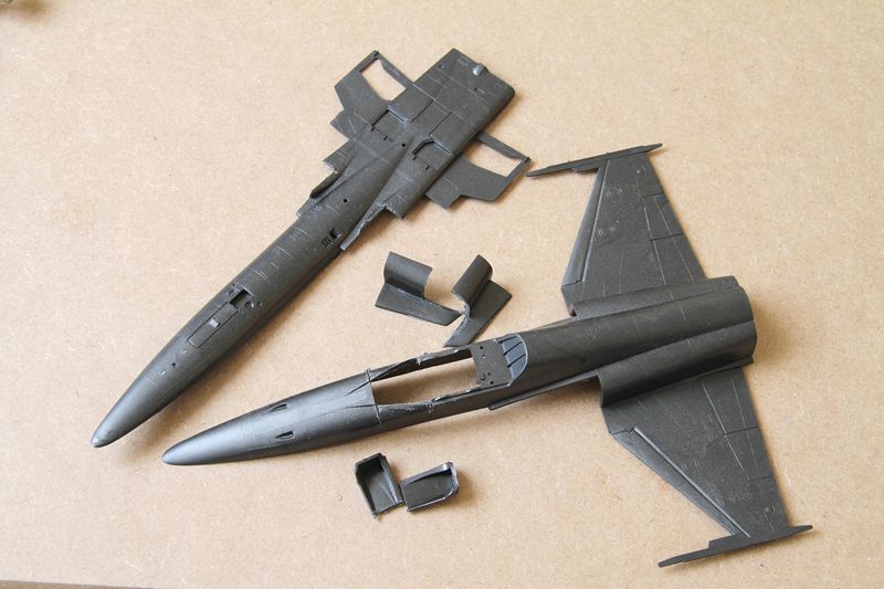

I fear there wouldn't be much of the F-20 once this project is over. What's left of her may go into the parts box. I've already cannibalized the instrument panel, cowl that covers instrument panel, splitter plates and intakes... :-\

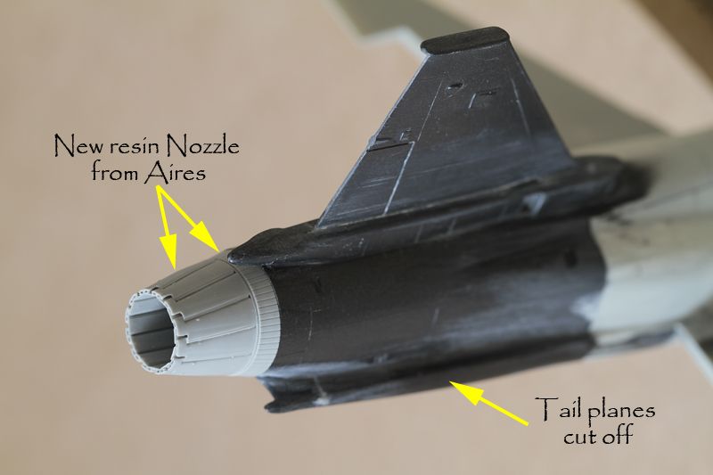

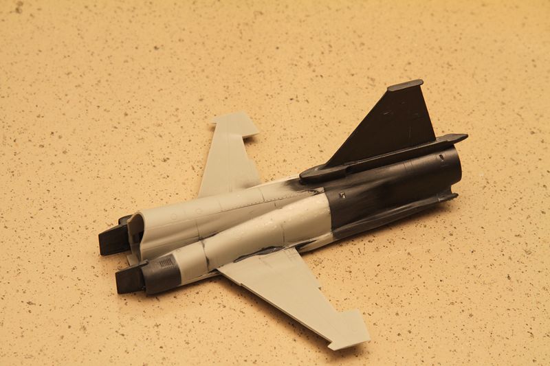

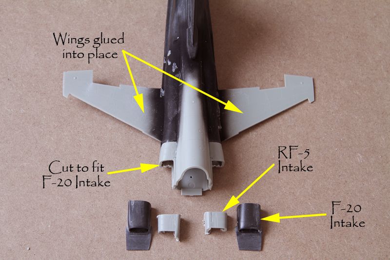

The next big step is intakes. Do I change the RF-5 intake to look like the F-20's or graft on the F-20's  :unsure:  The F-20 intakes have larger openings and the splitter plates is totally different from the RF-5s. After some time trying to figure how to make the RF-5 intakes into look alike F-20 intakes, I figure just build and graft the F-20 intakes on. So the F-20 intakes are in 3 parts, the splitter plate, upper and lower intake. There is a small vent on the upper intake which I want to save. So after the intake were all together, I cut them off the F-20 fuselage just behind the small vent. Now with the new intakes in hand, I can eyeball where I got to cut the RF-5 intakes off and fit the new intakes. In the pic below, you can see the RF-5 intakes removed and the F-20's all sanded and ready to be glued into place. I also glued and fitted the wings to the fuselage.
Here she is with her new F-20 intakes glued and fitted.
I want to reposition the tail planes, so with my razor saw, I remove them. Later I will add a piece of aluminum tubing to the fuselage and tail plane. After looking at the kits nozzle, I decided to replace it. The F-20 was powered by a single General Electric F404 engine. Guess what else is powered by a single 404, the JAS-39! so I order Aires closed nozzle for the JAS-39. Another jem. Molded and cast beautifully  :wub:  Only some minor cutting and sanding to get it to mate up with the F-20. It's not glued into place yet, just mocked up for photo.
