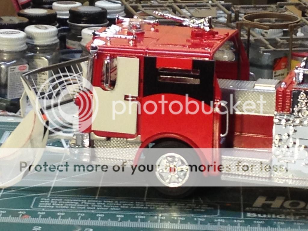

I've been working on the plow lately. I attached the horns and other chrome pieces earlier this week. I added some structure above the plow to keep zombie parts from getting all over the windshield.
Kind of a zombie strainer.
Added the ring mount behind the cab. The third leg will attach to a built out part of the armor.
First attempt at hillbilly armor. I used plastic from a sign so forgive the odd colors on some parts.
I want to bring the armor further down the body of the truck with a door to get in and out of the back of the cab.
I recieved the Micro Mark Rust and Dust. I can't wait to try it. I also recieved some Aves from the SSM store. Nice quick shipping!

« Reply #41 on: May 05, 2013, 08:43:12 pm »
Coming along very nicely, kerick! Very nicely indeed! :thumbsup:
Love the rough'n'ready look to the "zombie strainer". ;)
Guy

Thanks. I want the whole thing to look improvised by some farm boys using found scrap and junk. This is where the rust will come in.

I found some Krylon "Ruddy Brown" primer at Wallyworld. I sprayed some on to see if it would make a good base for rusty armor plates. Tell me what you think.
I also built some protection for the windshield. Its spaced far enough from the windshield to allow the wipers to work. Have to wash off the zombie juice once and a while.
A lot of work with the Rust and Dust will be required but I think its a start.
