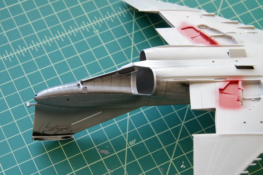

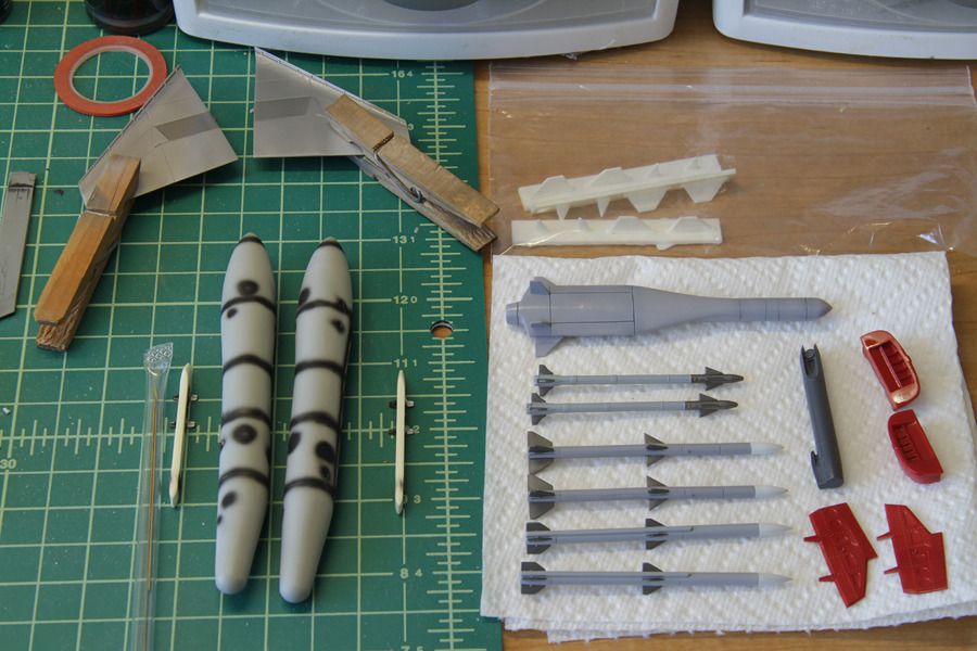

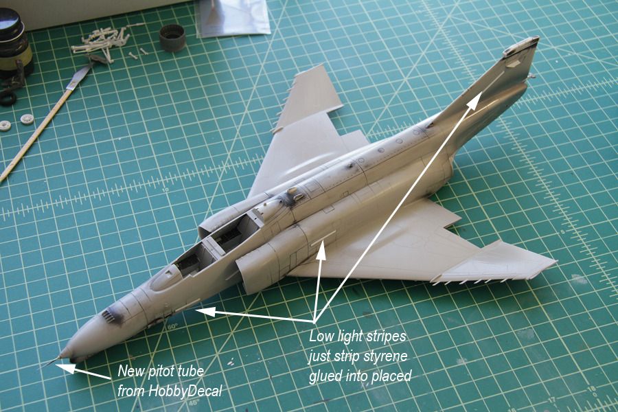

Well... It's been a while since I last posted. Work has been crazy but I have been working on my F-4. She is really close to paint. Unfortunately, I have not taken many pics of my progress. The time I felt like building, didn't feel like or have time to shoot before bed time. I did get all her metal paint work on the tail area done, AIM-9X's and AIM-120's are painted and ready for a clear coat and decals, Sniper pod and ECM pod are ready for decals, drop tanks are preshaded and ready for paint. Today want to finish up work on the two inboard weapon stations.
Here's a few shots from today.

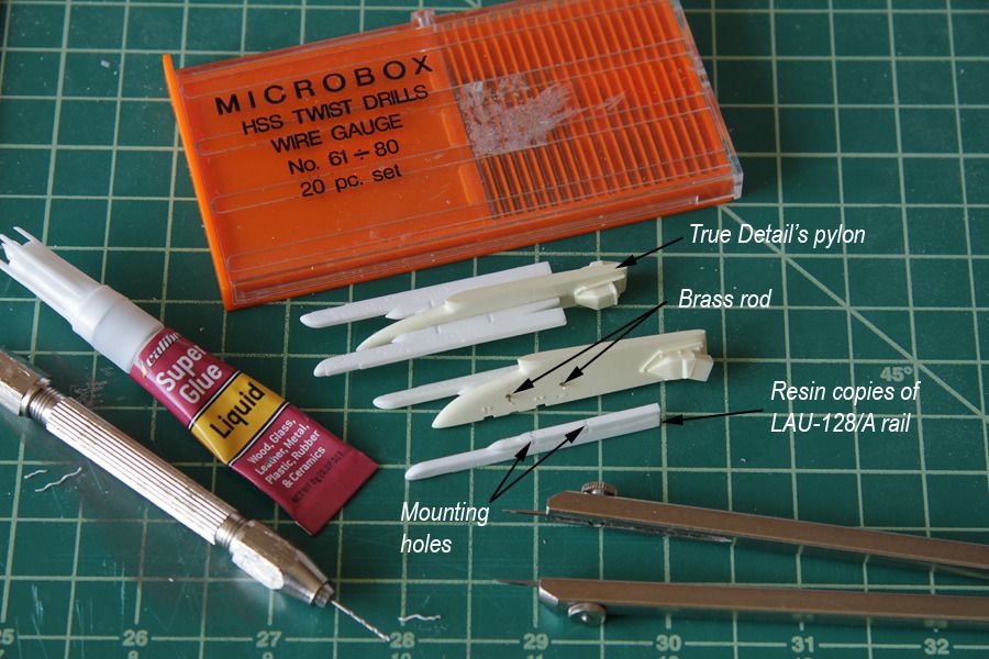

So,  I got the two inboard weapon stations put together.Combining True Detail's USAF F-4 pylons and my resin LAU-128 missile rails. Because of the resin on resin butt joint, I reinforced the joint with some brass rod.
Oh yeah since the first post to now, I have changed the weapons loadout. It was a shorty targeting pod, 3 AIM-120's and 2 AIM-9X's. Now it's a Sniper pod and a AN/ALQ-184 ECM pod in the front two Sparrow wells and 2 AIM-120's in the rear wells. The two inboard weapon stations will have a AIM-9X, a AIM-120 and a AGM-84L SLAM-shorty.

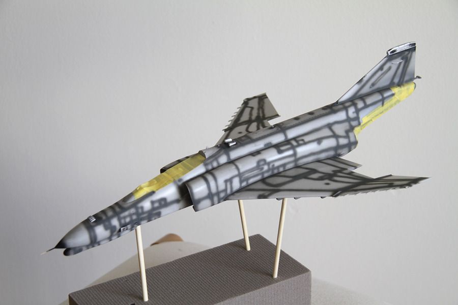

She preshaded and paint starts tomorrow!
